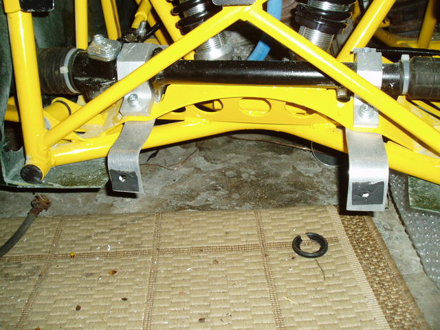

| posted on 12/3/11 at 09:14 PM |
you could fit another set of rubber bonnet catches on the outside to secure the nose from the back, and make a pair of L-shaped alloy brackets bolted
to the underside of the steering rack mounts! i used riv nuts like you on the inside but made mounts for the bottom edge. take a look in my blog. the
nose fits perfectly.

daniel mason
| posted on 13/3/11 at 03:56 PM |
this is what i did to secure the front
