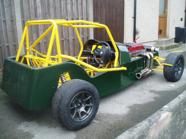

hi daniel any pics of the wheels you have?
and do they fit over std sierra rear discs and calipers of is it a small mod req?

this is the best one i have at the moment, from a while back. they are 13" caterham r500 rims with a048's

Hi daniel
thanks for the pics,
do the fit under the std rear arches then? or do you have to go for a wider rear arch etc? and same for the fronts?
sorry for all the questions,
daniel mason
posted on 7/4/11 at 08:13 PM Reply With Quote
i think most people run 185/60/13 fronts but the mnr front upright and wing stays (which are part of the upright) are designed for a 195/50/15 rim which would have meant a huge gap between arch and tyre. so i decides to go 205/60/13 which is similar. it fits under the arch fine.
as for the rears. a guy on here sells a modified caliper spring which is one coil smaller and the rims fit fine
