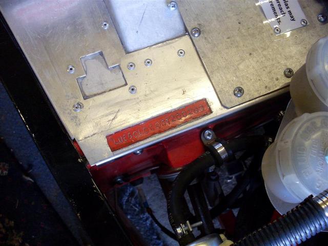

Also - I failed my test by putting it under the nosecone - had to resite it. see photo.

It was the VIN number - I'd stamped it into the only available bit of chassis tube available on the RHS. He didn't like it there as it
wasn't readily visible with the bonnet off. He suggested I made the hole in the ally footwell cover to access the rail underneath. This is
what I ended up doing.
