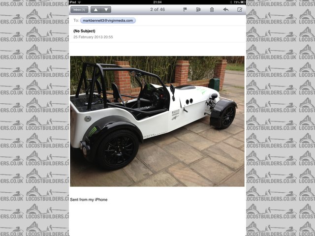

I've put a couple of photos in my archive from today, not great taken on my phone in the rain! haven't worked out how to put them in this
bit yet.

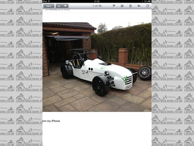

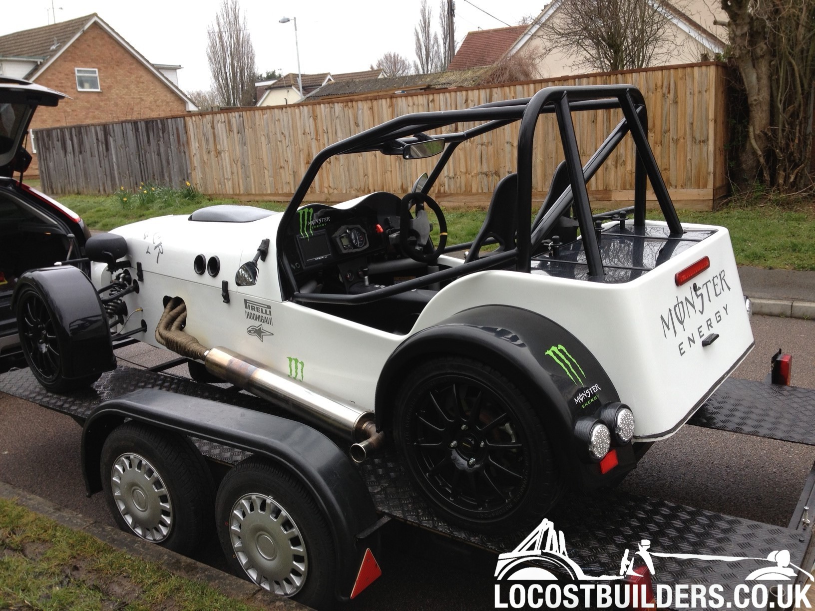

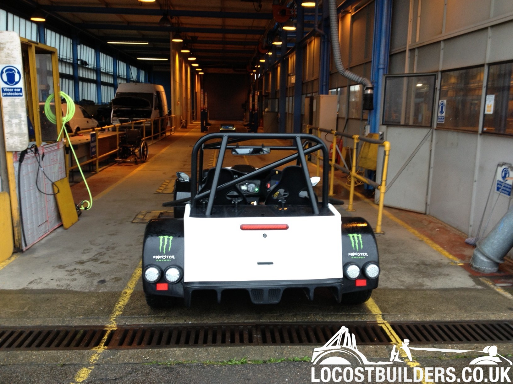

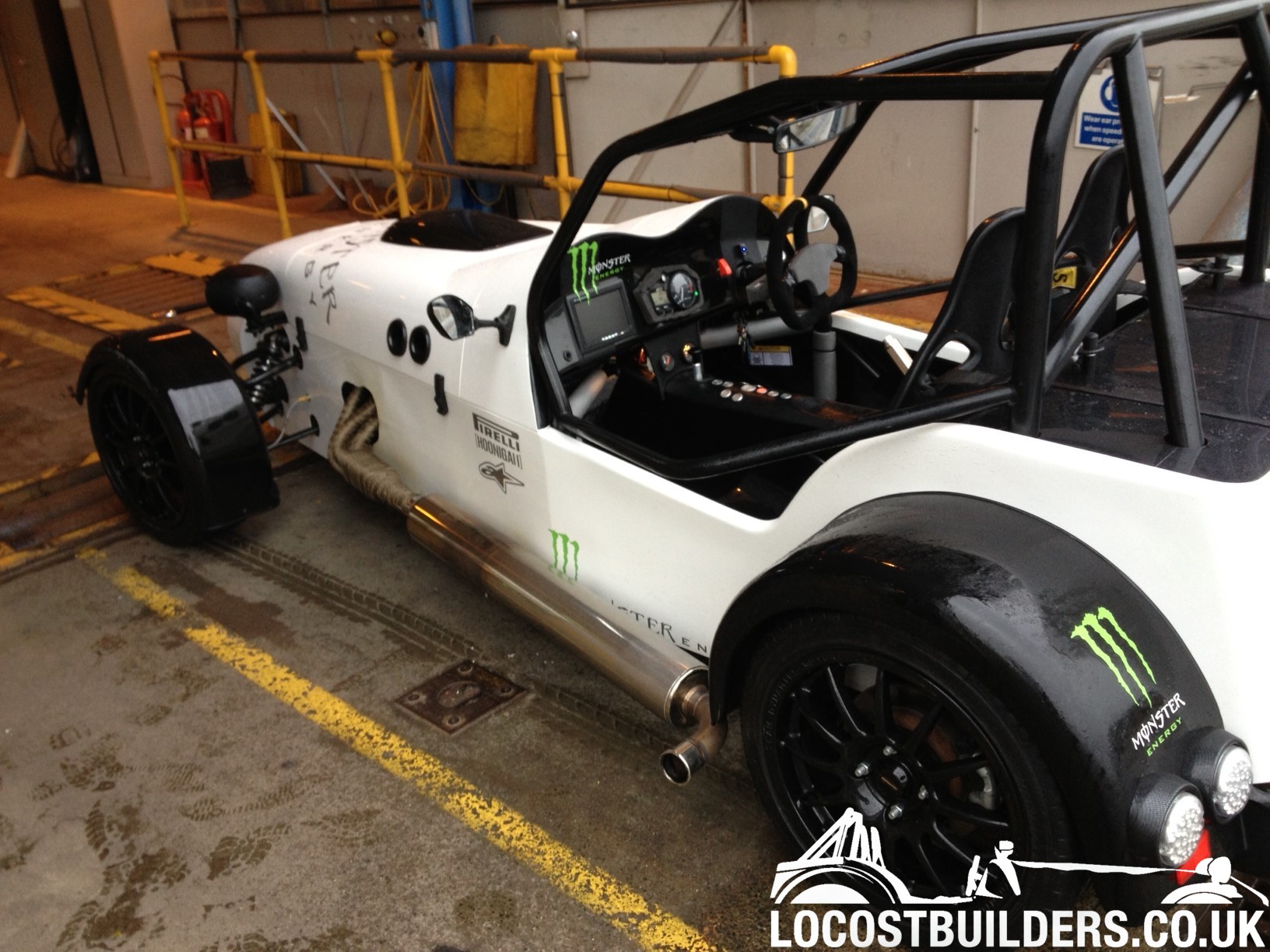

Thanks for the help re getting the photos on here, hopefully this will work, here are a couple of snaps from the day.
[img] [/img]
Markyb13
| posted on 13/4/13 at 06:27 PM |
Apologies they seem to be a bit BIG !!! As you can see we had to remove th rear diffuser during the test so he could examine everything.
