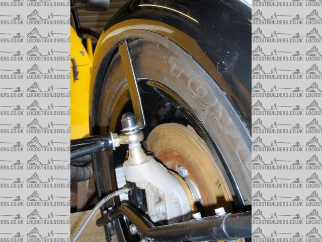

I know someone that had the same problem he repaid it and fitted a stay from the top ball joint to the top of the wing that stopped the wing wobbling from side to side

That was me Picture as below. Its been fine ever since i did it way back when... only change ive made since is i have also bolted the flatbar to the wing as it was just tigersealed to start with
wing stay
wing stay

I also did the mod davey posted up and it's worked well, think I had one fail since but they are 10 times stronger
