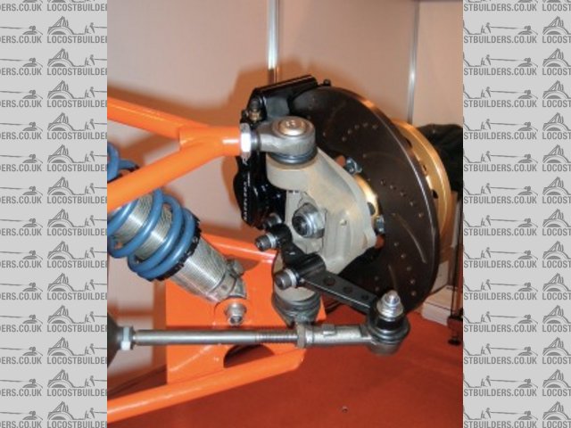

britishtrident
| posted on 17/3/06 at 08:33 PM |
M12 ?
mnr laptop
| posted on 17/3/06 at 09:16 PM |
thats an old picture, those are the early uprights, newer ones are a different stub axle, casting, and steering arm depending on which upright kit you
get
best regards
marc
[Edited on 17/3/06 by mnr laptop]
