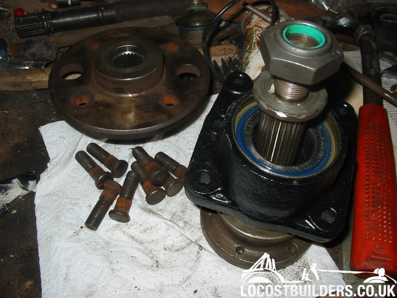

Does anyone have pics of'em mounted on the bearing carrier?
thanks,
Joao
ned
| posted on 16/5/06 at 03:50 PM |
best i can do:
http://www.locostbuilders.co.uk/upload/IMG_1713b.jpg
Ned.
