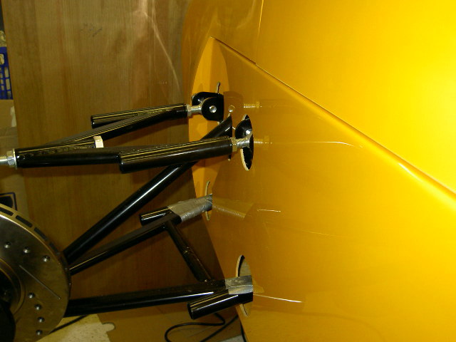

Hi all.
Could you guys take some photos of the nose and side panel contact zone?
As the nose is round and the side panel is square, I'm not sure how it will align ...
Also if you could also take some photos from the suspension holes plus the steering rack I would appreciate a lot.
Thanks in advance,
Joao
amalyos
| posted on 14/6/06 at 03:05 PM |
Happy fitting
Steve.
amalyos

JoaoCaldeira
| posted on 15/6/06 at 07:59 PM |
Thank you very much, Steve.
I wasn't sure about how to fit a round nose to a straight side (vertical wise, I mean)
Anyone with a RT?
Thanks again,
Joao

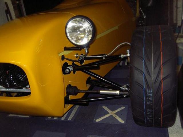

RichieC
| posted on 16/6/06 at 06:36 AM |
Ill get you some pics today Joao. I got a little carried away by cutting slightly too much back on one side of the tub. I evened them up and used
some trim. This also has the benefit of being flexible.
Small amounts bit by bit is the way to go to get the best line between nose and side panels.
Rgds
Rich
[Edited on 16/6/06 by RichieC]

JoaoCaldeira
| posted on 18/6/06 at 06:03 AM |
quote: Originally posted by RichieC
I got a little carried away by cutting slightly too much back on one side of the tub. I evened them up and used some trim.
Actually, this make 2 of us!! I didn't realise that the nose is round in both planes and make the cut on the side panel straight!!!
Can you post some pics of what you've done, plese?
Thanks,
Joao
RichieC
| posted on 18/6/06 at 09:18 AM |
Yeh, Sorry Joao, Ill go and take some now for you...................
Rgds
Richie

RichieC
| posted on 19/6/06 at 07:15 AM |
I have a rivet on the top into the intersection of the chassis rails and a couple from underneath, rock solid
Rgds
Rich
