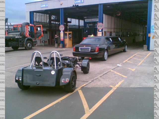

SVA Pass at Beverley today!
Hi All,
Passed at Beverley this afternoon. Still very close on the sound level though. Last time with race can and decibel killer I was 102db this time with
R1 can I was 102db although it sounded a hell off alot quieter. So I was given 15mins to dismantle a red hot exhaust and put the db killer in again.
This time it was 99 to 101. I am not convinced that most of the noise is from the exhaust, I think the majority is from inder the bonnet etc.
Anyway they liked the electric handbrake and it passed with flying colours. I may look at offering these as a kit if anyone is interested. I will
guage response.
Thanks to people on this forum who have helped with gems of wisdom!
