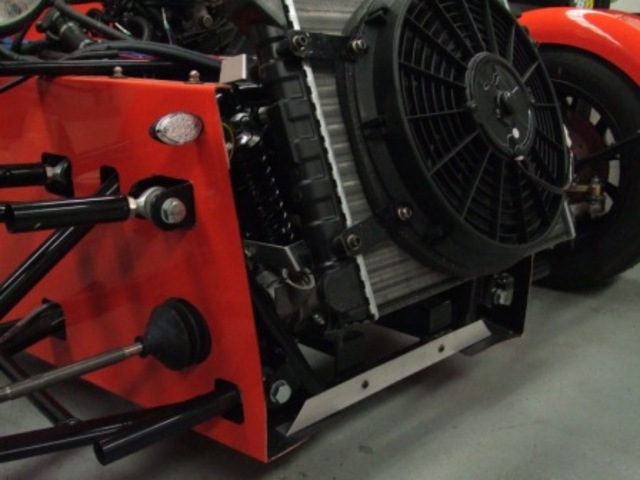

My car was built for track use only so quick removal of everything is important.
The front panels are joined together at the correct width with a piece of alloy angle 25x25x1mm and rivnuts. Two rivnuts hold the alloy angle to the
chassis. It's neater than it sounds. The nose is held on with slide clips and can be removed in a jiffy. As is the scuttle. The bonnet is held
on by dzus fasteners.
Two M5 stainless buttonheads hold the tub on, one each side, tapped into the chassis just in front of the rear wheels.
The radiator is also mounted on rubber lined 25mm P-clips the idea being that they stop a bit of vibration and save drilling holes in the chassis. It
was worthwile when I needed to change the angle slightly due to hot weather.

My new chassis has just arrived and I'm not sure how the P-clip radiator mounts will go with the new chassis being so low at the front. (You can
see them in suspension photo) If it was the same as the old one I could send bracket drawings. They are very secure and I can't see them breaking
for a while but I will keep an eye on them anyway.
  front suspension
[img]/upload/MNR0050 012.jpg[/img]
[img]/upload/2MNR0050 002.jpg[/img]
First go at posting pics so if they don't turn out they are in my archive.
