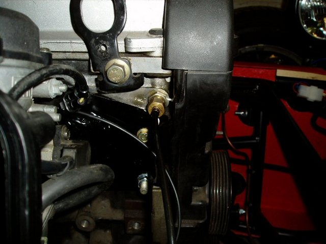

Founs this handy place for the oil pressure pipe while trying to find out how big the switch was so I could get a T piece. In the end no
need!!
