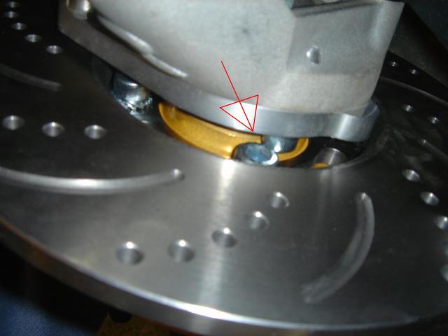

Raceleda front end
on behalf of a friend...
I'm having a problem with the Raceleda setup, where the hub bolts are hitting the calipper support bracket (on one side, the other is marginally
safe).
Check please the red arrow.
Can you please post some pics of a similar setup?
Thanks,
Joao

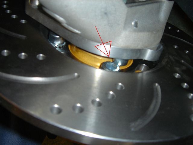

any better?

You could either use normal hex head bolts or grind the cap heads down a bit.
Personally I wouldn't use those crinkly washers either either a normal spring washer or none at all with a bit of loctite.
HTH
Mark

mine have about 3mm clearance - are you using the right spring washer? And shallow head bolts?

Yeap... change the bolt type seems to be the answer...
How close can I leave it? It's supposed to be fixed anyway... not a moving part so I guess pretty close can be an answer...
Thanks,
Joao
| posted on 28/10/07 at 11:52 AM |
1mm is plenty, until your bearings wear out! My mate put some alloy wheels on his car which gradually took the writing of his brake calipers!
