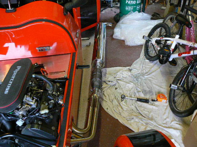

I have a problem with the loan Cat it is far too long and my silencer is too far back.
I really need either a short cat or a standard bike silencer that is a lot shorter than the MNR one.
If anyone can help please call me on 01473 745880. My SVA is Friday and I need this sorted Rescued attachment P1010098.JPG

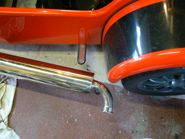

Krismc
posted on 18/6/08 at 05:55 PM Reply With Quote
can you not move your collector further back?? in the picture it looks like you have 8inchs to play with
[Edited on 18/6/08 by Krismc]
stuart_g
posted on 18/6/08 at 06:20 PM Reply With Quote
Would ideally like to do that but the collector will only go on 1 inch. I had this problem when I first fitted it. As soon as I put pipes 3 and 4 in and loosely attach them to the engine the collector will no longer move. Also I can not get it any closer to the car as you can see it points outward. I have tried to rotate all the pipes but this is as close as it will go.
The silencer needs to go at least 4 inches forward to clear the rear mudguard. there is not 4 inches of movement in the collector.
[Edited on 18/6/08 by stuart_g]

Stuart how long is the cat and what is the internal diameter

i had the same problem so cut the manifold down a bit.
didnt need the cat for my sva as it sailed through
its still really close to the rear wheel arch but the exit pipe i bent downwards at 45 degree angle

2.25" internal diameter both inlet and outlet and about 12" overall
[Edited on 18/6/08 by CRAIGR] Rescued attachment P6181989.JPG

shorten the manifold pipes, give me a ring tomorrow and i can tell you the length it needs to be measured against a car i have at work,
or i have a shorter can on my grey car you can borrow, or drill out rivetts in your can and shorten down the one you have as my shorter can just passed noise at sva at 96 db

Thanks for the suggestions/offers everyone. As time is running out I think I need to modify what I have here. I think I'll have to have the headers off and shorten them.
