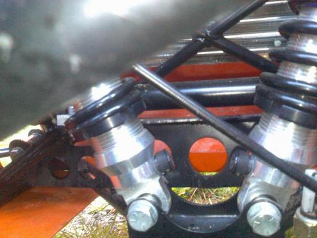

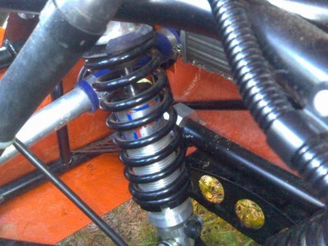

Johneturbo
posted on 22/7/08 at 06:44 PM Reply With Quote
Ok guys first of thanks for the replys, it's nice to know help is out there
i've taken a few pics and i'll try ans answer the Qs
the front springs are 175
i've tried all the settings on the shocks to no effect really.
front uprights are mnr cortina type.
ride hight is front 150mm
rear about 165mm
i can't get the front much lower as the springs are near the platforms and the pushrods are fully wound in
if i jack the car up the suspesion does droop down, but i will check the bushes as another thing to try.

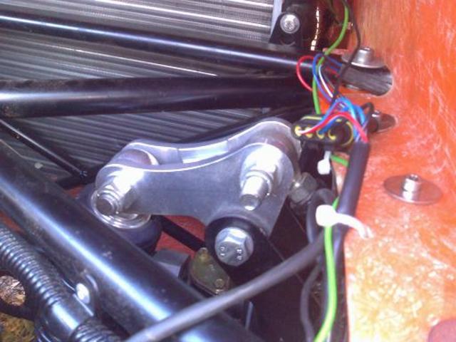

Johneturbo
posted on 22/7/08 at 06:45 PM Reply With Quote
Johneturbo

As Paul points out, the force required to move your wheels up and down is much higher than the 175lbs required for an inchof movement at the springs.
Obviously you need to check for something making the suspension reluctant to move, but if no fault is found then you are off to the spring shop
John

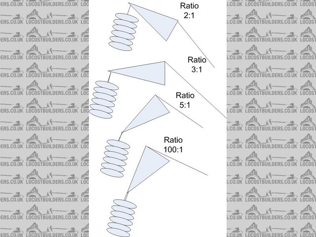

That triangle changing direction of the movement must be gearing you shock up 3:1 maybe more as its past right angles so the amount of energy to move increases even more, your 175lb springs are effectively 525lb. Thats your problem!
So you need less manly springs, and in the ideal world try and shorten the rod from the wishbone up to this to stop it going over centre.
Here's a crude drwaing hopefully showing what I am on about
[Edited on 22/7/08 by mark chandler] Rescued attachment drawing1.jpg

heh lots of advice,
I concur with the last post.
Using a bell crank for the inboard shocks will give you a rising rate shown by the ratio increasing with suspension movement in the last diagram.
If you have the spring and damper rates as for an outboard setup you'll be way to stiff might want to check what you asked for when you ordered your coilovers. you should be able to bounce on the front and get some movement.
Just a note why does everyone stiff refer to spring stiffness in pounds? I though we'd been metric for a few decades now (Nm) but saying that my springs came with force in pounds.

Johneturbo
posted on 22/7/08 at 08:18 PM Reply With Quote
Paul/Mark
i did wonder about the angle of the rocker, thats why i posted a pic of it.
my problem is the pushrod is as short as possible and my lower wishbone is still a nats wisker below horizontal.
so i've had to drop the springs down to get it as close as possible, but then that's made the rockers sit a lot lower than ideal i guess!?.
maybe a solution would be shorter pushrods?

Andy W
posted on 22/7/08 at 08:34 PM Reply With Quote
which way round is the bottom wishbone, is the push rod mounted on the top or bottom of the bone? this will alter the angle of the rocker
