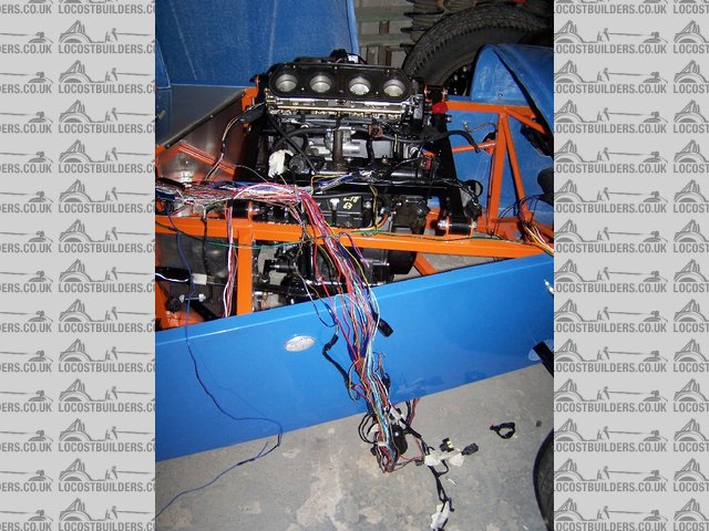

started wiring her up
well i fitted the engine over the weekend and started on the wiring after work today(thank god for BST) hopefully it will be runable this week,
fingers crossed

are you using the bike loom rich?

As Jos asked, are you using the full bike loom? I can see bits of bike connectors etc in the loom hanging to the floor, but are you going to use that
or are you going to make a full new (lightweight ) loom?

yes guys the loom is from the bike US zx10r i have ripped out quite a bit of it and added some back in due to strange US lighting requirements.
after this evenings wireup athon most of the circuits are identified,modified or removed. the fuel pump in the tank works which is a relief as i never
checked it before the tank was made.
so hopefully over the next couple of evenings i will start connecting up the cicuits and tidying up the loom hopefully to get it started at the
weekend

just do it Ash its strangely theroputic just work mathodically one circuit at a time, i'm sure you will find it easier than you think its
going to be

well the wirings a bit tidier and almost complete. Just the savage switches and hazzard circuit to sort

well the wirings a bit tidier and almost complete. Just the savage switches and hazzard circuit to sort out.
there's room in there for another engine Rich,
what you playing at!!!!!
