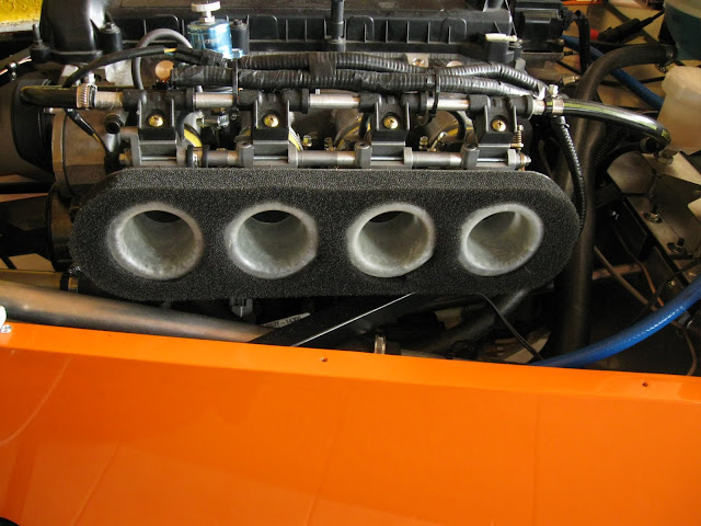

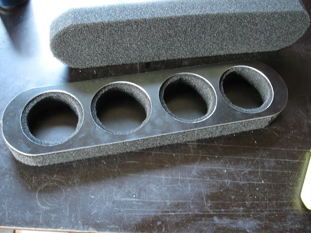

that's how I did it
i glued the foam on the edges and it works ok, foam is stiff enough and doesnt collapse
For limited milage I'd be fairly happy running without a filter at all, I did it for ~4 years on a daily driver (not a performance car!) and saw no change in compression/performance in that time. I'm slightly more cagey with my turbo but still considering it despite it being against conventional wisdom!
Radom - That's a neat job but I notice you havent left any free space in front of the trumpets. Consensus suggests that at least 20mm is needed
to prevent any power loss. Definitely a Locost solution though
