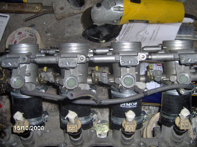

blanking throttle body holes
ive jut in the progress of respacing my GSXR600 throttle bodies for a zetec and have heard about blanking off the injector and secondary butterfly
holes with chemical metal.
Does this work and is it i long term solution? just worried about it gettin sucked out!
