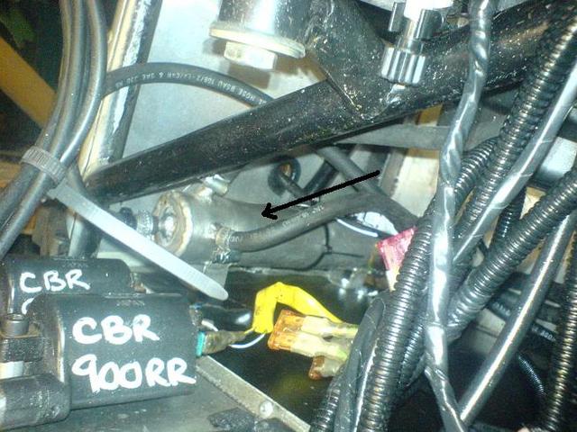

I had a swirlpot on my latest car (Audi S2 - 450 bhp)
I just used the originally pump to fill the pot and bought a hi-spec for the fuelrail.
Still running after 4 years.
Søren S2
[Edited on 2/1/09 by sorens2]

sorens2
| posted on 2/1/09 at 03:26 PM |
The ine in the pic is 1.1 L.
That´s more than enough at these powers.
I build it myself at work. 0 £
Søren S2

sorens2
| posted on 2/1/09 at 04:09 PM |
I´ll see what I can do.
Don´t work there anymore but have some of it here at home.
3" i dia. ?
5" tall ?
Soren S2
cd.thomson
| posted on 2/1/09 at 04:16 PM |
Yep sounds like a perfect size!
sorens2
| posted on 2/1/09 at 04:20 PM |
See if I can make 5 then.
And have some on stock.
Søren S2
