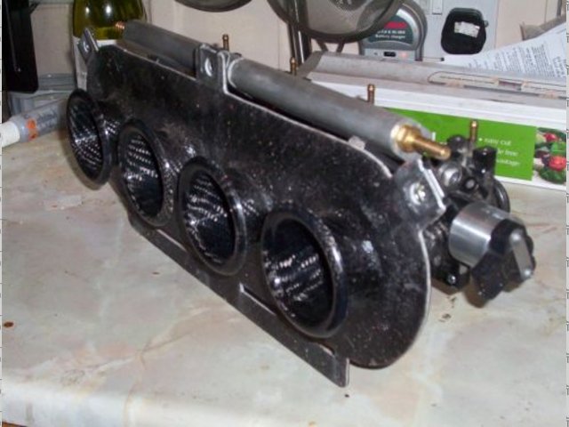

clairetoo
| posted on 23/1/10 at 08:24 PM |
Heres some I did a while ago - home-made carbon trumpets
  GSX600 throttle bodies
For a filter these are then bonded to the backplate
  Crossflow bodies
And then finished off with a carbon airbox
[img][/img]
Its cuz I is blond , innit
Claire xx
Will weld for food......
lotusmadandy
| posted on 23/1/10 at 08:26 PM |
Bloody hell Claire, i want your tallent

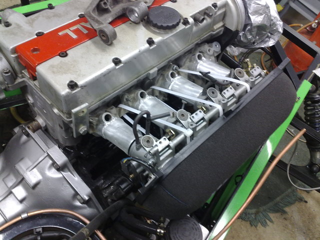

T Rex
posted on 23/1/10 at 09:03 PM |
these are mine on an XE
lotusmadandy
| posted on 23/1/10 at 09:06 PM |
Rex, that's a nice filter. Who made it,Pipercross,ITG.....?

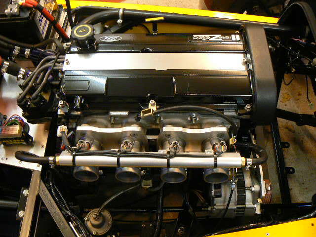

scutter
| posted on 23/1/10 at 09:08 PM |
ST170 manifold, 2.0L mondeo fuel rail, throttle bodies with bike inlet trumpets.
Claire, fancy making another set of trumpets and airbox, that looks fantastic?
  bodies
ATB Dan.
lotusmadandy
| posted on 23/1/10 at 09:12 PM |
What are the trumpets from Dan?
T Rex
| posted on 23/1/10 at 09:13 PM |
Sorry about the picture
This is during a trial fitting the entire Assembly had to fit under the bonnet, Hence the tieraps.
lotusmadandy
| posted on 23/1/10 at 09:20 PM |
We've all been there Rex,i would still like to know who made your filter mate.
scutter
| posted on 23/1/10 at 09:21 PM |
Andy, they are the GSXR ones, for the life of me i can't remember which size engine it was.
ATB Dan.

T Rex
| posted on 23/1/10 at 09:32 PM |
lotusmadandy
the filter is from Pipercross.
lotusmadandy
| posted on 23/1/10 at 09:33 PM |
Cheers Rex and by the way,welcome
