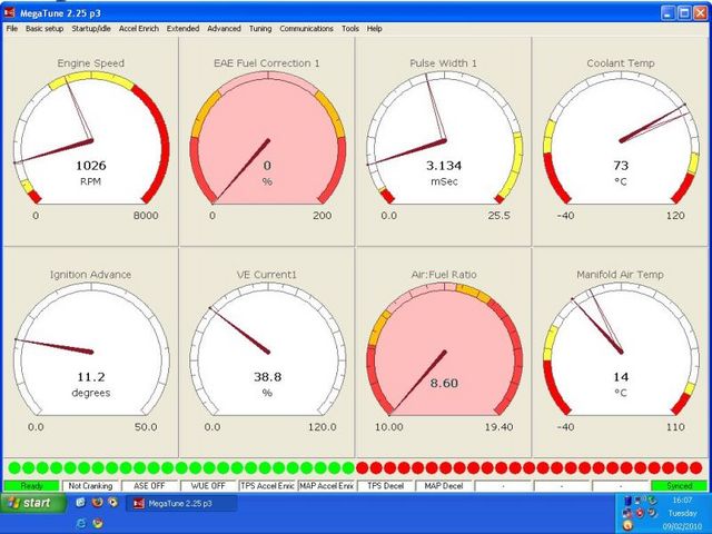

| posted on 9/2/10 at 04:16 PM |
Thanks for the guidence mates, I'm running MS2 extra with alpha_n.
I've recalculated the req-fuel at 10.6 for my injectors and generated a new fuel table.
Its running a lot better now and idling quite stable and not killing me with fumes!
I'm struggling to calibrate my LC1 in though so ignore the O2 readings here. My on dash gauge is showing 16 atm.
Heres a real time mpeg of the current state, revving it now it coughs and backfires flames out the exhaust, thats the next step me thinks!

flak monkey
| posted on 9/2/10 at 04:24 PM |
Is your LC1 set to factory default and you are using the right output i.e the 0-5v one?
If so it should be as simple as selecting it in configurator and in the lambda setting page.
PS use tuner studio rather than megatune, its much nicer to use and has live tune etc all built in.
Sera
http://www.motosera.com
| posted on 9/2/10 at 07:13 PM |
LC 1 is wired as it says in the megamanual. Its connected to aux output 2 (yellow wire) which I know replicates a narrow band with a 1v range. The
manual says this is ok and just to select the Innovate default in the afr calibrator... however as you can see it does not work.
I want to keep the dash gauge as a comparator and program the LC to output 5v but I cannot get the laptop to communicate with the LC 1. Common problem
I believe which I am waiting on a usb/serial converter to see if that works. Otherwise I will be rewiring the damn thing.
And yes, I will give Tuner Studio a bash.
Thanks David,
