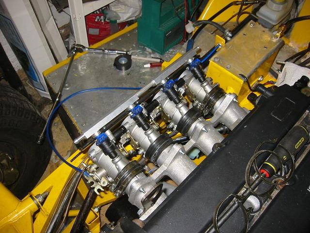

Starting to come together now... fabricated a bracket for the injector rail.
Glade
| posted on 22/10/11 at 04:22 PM |
Started to mount everything up properly now...
Fitted the adaptor plates with some Loctite Copper Silicone
Extended the throttle linkages with Aluminium L-shape
Spaced the throttle bodies using M6 threaded bar, and some M6 flanged nuts to maintain the spacing. Mounted it all up and sealed the bodies to the
adaptors with more copper silicone.
Fitted the throttle cable. Think I need to find something more suitable.
Found that the trumpets off my old Dellorto carbs fitted perfectly. Will fabricate a bracket to keep them all together, but I think they'll stay
in place with the slight interference fit and some more silicone.
Popped the bonnet back on... doesn't quite fill the gap like it used to.
Next is electrics and the High pressure fuel system.
matt_gsxr
| posted on 22/10/11 at 07:34 PM |
Nice write-up.
My only slight concern would be your use of aluminium as the throttle coupler. Having bent quite a lot of aluminium I would worry that over time it
will end up distorting and upsetting your throttle balance and resulting on the right hand two cylinders running a bit lean on tip-in (as the TPS is
on the right hand end).
Matt

Glade
| posted on 23/10/11 at 09:25 PM |
quote: Originally posted by matt_gsxr
Nice write-up.
Matt
I think I'll revisit it... I think there will also be some slack on some of the rivets.
Also the thickness of the material means that the throttle balance is a bit out.
Maybe steel, and a different mounting arrangement. Bonded and riveted, with some sort of dogleg so they are extended in the same plane as the original
linkage.
