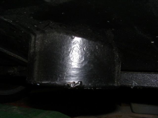

Here are a couple of pictures showing the top and the well in the tank. One thing that I foregot was that the pump comes without any means of fixing
it in, as on the L/Rover its held down by a threaded ring, so I had to make a holding down ring, and fit rivnuts into the tank top. HTH Ray

  Tank well

The pump itself is a swirl pot with the pump located in it, the complete thing is supported on two S/Steel rods that are spring loaded. You drop the
pump unit into the tank, and then press down on the springs and fix the holding down ring. The depth required overall, is I think 10 inches to get
it to fit. As I said its not a simple job. I only did it this way as I was making up a new tank anyway. Cheers Ray
