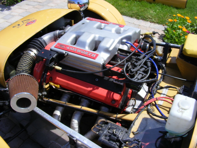

Picture of exactly what you are refering to would help, but I think that you are talking about is the air flow metters.
[img]
  Ready for air filters.
[/img]
This is what I did with mine, set up the Air Flow Metters so that the air filters went through the side of the bonnet and into the fresh air, worked
well with the 12 Valve. HTH Ray
[img]
[/img]
This is what I have now, but it shows the air filter fixing, to give an idea.
[Edited on 2-9-12 by Chippy]

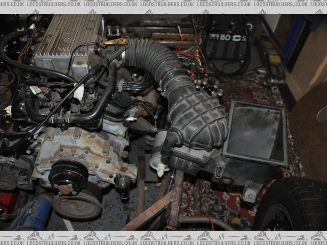

Namyllegin
| posted on 2/9/12 at 08:24 PM |
Xr4x4 fuel distributor
Good idea Chippy,
hopefully photo attached _ if I've done it right ?????
Anyway, the bit I'm looking to relocate is the black lump on the right. It is a K Jetronic system so is not too complicated - hopefully.
Nigel
[Edited on 2/9/12 by Namyllegin]
[img]http://
  XR4x4 Fuel distributor
[/img]
Chippy
| posted on 2/9/12 at 09:37 PM |
I think that is the resonator box, may contain the air filter as well. Not had much to do with the 2.8, but on the 2.9 I just scrapped all that junk
and fitted just the air flow metters, (two on the 2.9), didn't make any difference to the running, in fact upped the BHP a fair bit. While I
cant tell you what effect it would have on your engine, I would suggest that you do the same, and just see how it runs. HTH Ray

Chippy
| posted on 3/9/12 at 09:57 PM |
What's to stop you doing as I have shown in the picture.
[img]
[/img]
The air/filter box is just not required, and the section of pipe between the white lines can be shortened. Or is there something about the fuel set up
that makes that not possable?
Cheers Ray
