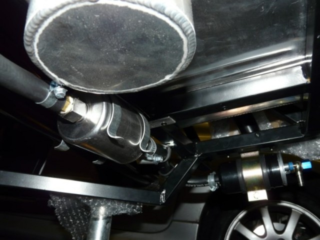

adithorp
| posted on 5/4/13 at 10:23 PM |
The silver strip at the top is an ally strip bolted across the chassis/diff cage. There's then 3 rubber bobbins between that and the ally that
the pump and filter are attached to.
I did have the plastic 6.5 gallon Fisher tank originally (think it's still on in the pic's) but now have an ally one. The feed connection
on both is a banjo fitting. I made a gauze strainer by wrapping some fine stainless mesh around a piece of thin bar several times until the the
outside diameter was just a fit in the hole into the tank. Then I twisted one end to close it of and removed the bar leaving a cigar shaped gauze
tube (same length as the tanks sump). I then splayed the other end a bit so that the banjo bolt could trap it at the bottom of the tread. Insert into
feed and connect up. I initially added a pre=filter between the tank and pump but it collected nothing so I removed it (the ends were too small really
for the 12mm feed pipe). Coming up to 20,000 miles like that.
http://jpsc.org.uk/forum/
