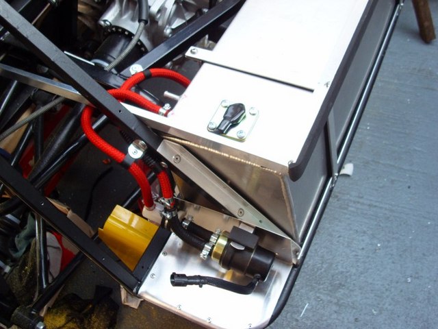

  Fuel pump mounting

jacko
| posted on 6/8/13 at 06:30 PM |
  35l fuel tank over diff
I have just found a photo of my fuel tank as you can see the fuel comes out the top
Jacko
