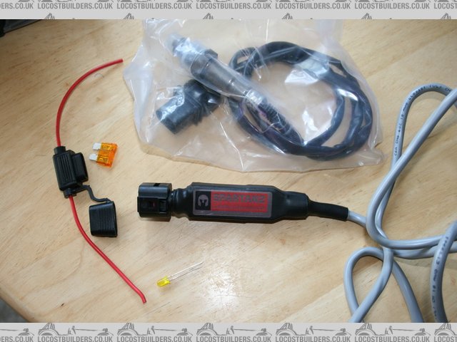

14point7 SPARTAN 2 Wideband AFR
My previously "trusty old" Techedge Wideband recently threw a wobbly then expired just as I was putting the finishing touches to my VE
table following a throttle bodies install. Techedge were unable to help so I had it checked over by a UK supplier who pronounced it dead.
Looking around the net I came across the SPARTAN 2 Wideband made by 14point7.
£120 from Phil at ExtraEFI including the BOSCH sensor. It was easy to fit and easy to interface with my Megasquirt ECU.
The kit includes an LED to indicate sensor tip temperature.
Initial testing using VE AnalyzeLive showed discrepancies in my VE table that I suspect arose when the Techedge was failing.
Most of the table was showing rich.
Half a dozen sessions later the table is virtually static. I'll probably get it on the rollers for final tweaks.
When first switched on it sends two calibration signals for five seconds each. 13.33 AFR then 16.66.
My laptop registers these as 13.37 and 16.71 using TunerStudio software. So within 0.05
If you have MS2 or MS3 there is an Excel based correction calculator on the 14point7 website to get the calibration perfect.
There's a support forum on the website too.
It seems to be performing well for a budget unit.
Only time will tell.
