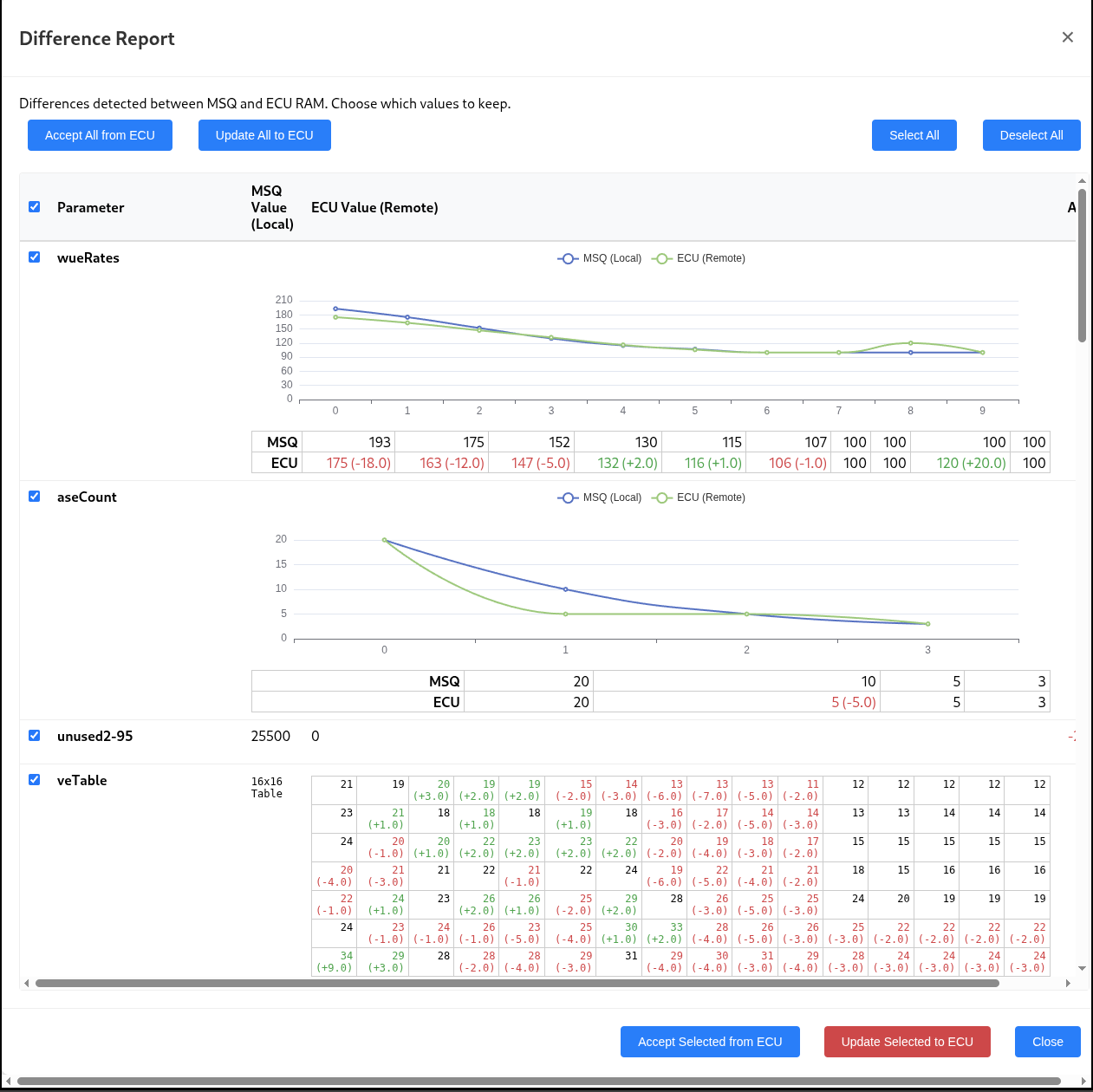

One of the nice things about doing this is I can fix the things that annoy me in TunerStudio
Top of the list is the tune difference dialog. I can never see the differences in the tables or curves, so this app will show delta tables and draw both curves together. You can also select which fields you're going to select as well.
Difference Report
Difference Report
scudderfish
posted on 17/1/26 at 03:41 PM Reply With Quote
Ah, the joy of LCB images. Here is a legible version
