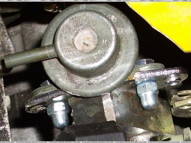

Monkeybasher
| posted on 6/2/06 at 06:36 PM |
In the end I used a Ford probe regulator on the end of the fuel rail. It doesnt fit as standard. The reg is a tiny bit biggar. I filed it down and
drilled new fixing holes and it works a treat. I used the O ring from the removed pressure sensor. There is no hint of a leak but I will keep a very
close eye on it initially.
