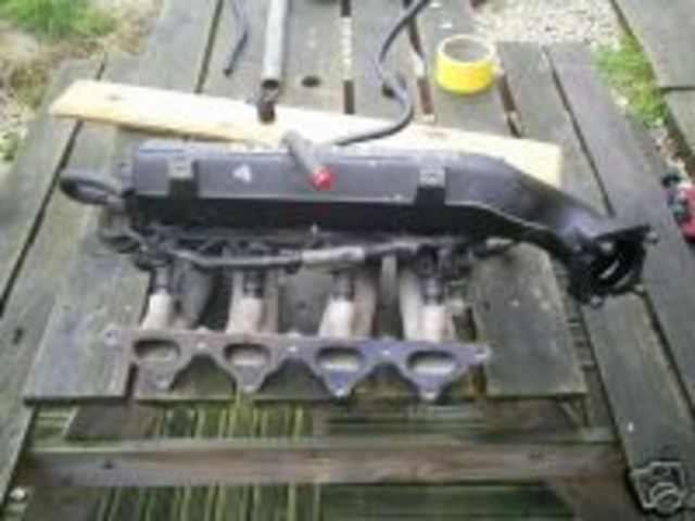

britishtrident
| posted on 31/3/06 at 07:10 AM |
Rover T16Mpi or Turbo manifold can be fitted to the Zetec not sure of the clearance issues in a Locost I have bought one but haven't got it
yet.

MikeRJ
| posted on 1/4/06 at 04:54 PM |
quote: Originally posted by britishtrident
Rover T16Mpi or Turbo manifold can be fitted to the Zetec not sure of the clearance issues in a Locost I have bought one but haven't got it yet.
Do all the bolt holes etc. line up?
britishtrident
| posted on 1/4/06 at 08:09 PM |
Rover manifold needs an adaptor plate can be bought off the shelf at a silly price but would be easy to make up -- especially for a group buy getting
them CNC machined.
