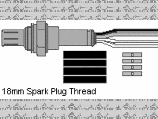

What type no you need ? various technologies used and different configurations.
Standard "universal" Zirconnia narrow band ones come in 1, 2 , 3 or 4 wire types --- most production cars use 4 wire types these days.
Connections are signal, signal earth, heater and heater earth
