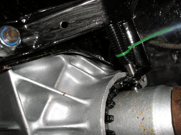

Is this any good. Used the mounting bolt of the sierra diff. Single magnet araldited/superglued into a drilled "dimple" on the driveshaft. once the wheel circumference had been calculated and programmed into the Vapor unit it works fine. I was completely amazed when this setup passed the SVA regs first time
[img][/img]
