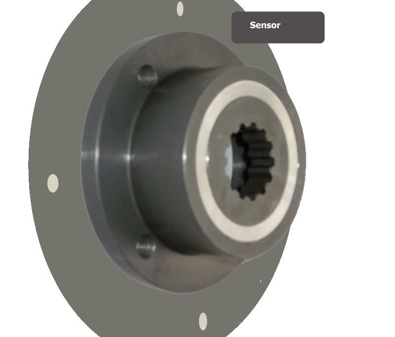

Second quesiton is related to the speed sensor I have for my Koso. I'm assuming its pretty similar for any electric speedo. I have some magnets to put on the prop. Most people seem to have drilled the prop adaptor but I'm strugeling as mine is hard as nails. I was thinking of turning a piece of ally so it bolts between the adaptor and the prop and then drilling the side of this piece for the magnets to fit. I've drawn up a tacky diagram to help make sense of my rambelings.
Ideas on this one please chaps, good idea or not? My thinking is that the magnets are less likely to come out as the centrifugal forces are thowing it outwards there is nowhere for them to go as they'll be fitted from the side. On the other hand is it a bad idea to have an extra plate on the prop as it may crush over time and the bolts come loose?

£20 for similar from here
Mark G
posted on 16/12/08 at 08:39 PM Reply With Quote
Thats the sort of thing. Would ally be too soft?

I drilled my magnets into one of the output flanges on the diff. Was suprisingly/worryingly easy to drill

Good idea, but I don't have output flanges, My shafts are men and my diff's a bit of a girl.

As for the prop, you would have to be very carful not to imbalance the prop. I remember seeing a post a couple of year back with pics of the prop breaking and coming through the tranny tunnel

A hall effect sensor like the one in the etb site needs a magnetic effect of some description so the disk needs to be steel not ally. However, to use the ETB one it really needs to be used with a fixed diff and not a live axle as the tollerances are quite tight.

It doesn't need to be steel as the sensor picks up the readings from the magnets you install in the ring, not the cutouts in the ring. Although I appreciate the input about the tolerances.
