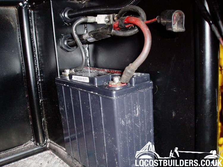

I have a threaded post welded into the chassis, where the battery -ve and engine earthing strap are bolted down. So Option 1 was my choice!
