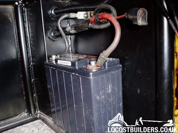

posted on 24/12/08 at 12:13 PM Reply With Quote
I used electrical glands like the pic above. Got them in B&Q.
You can just see them above the battery....
