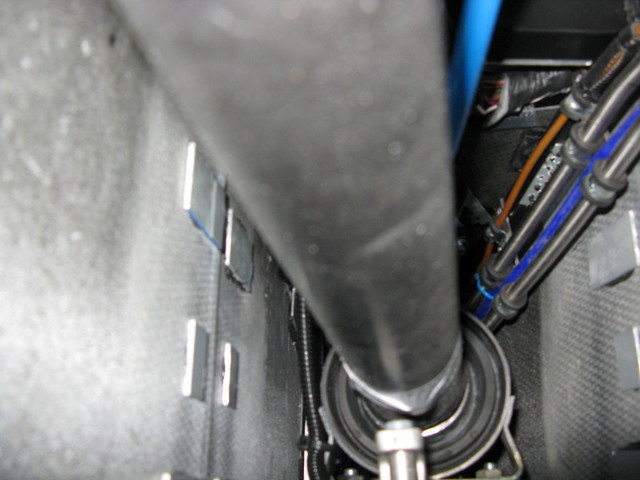

Done loads of searching on here, but what's the best way people have routed electrics through trans tunnel? I have brake line on top drivers
side, fuel on bottom passenger side. Plan is to run electrics on same side as fuel but at top. Any issues with this??? Some pics of what you have
done would be very useful.

i can't really see it makes a huge amount of difference, but i'd put it on the same side as the brakes.
on my car, i'm actually running brake lines and electrics inside the cab, because fuel and exhaust has to go in the tunnel

ive done it top of the passenger side, just make sure that its securely fitted, nothing hanging that could catch the prop say. Either use the cable
tie things riveted in, or use p clips.
Shouldnt be a problem

Same as mine, ran the wires along the top opposite the brake line. Wrapped in spiral and split convoluted stuff...

I've got fuel lines on driver's side, brake + leccy on the other side.

Brakes and fuel down one side, and my electrics go down the other side (all at the top). No problems with their routing, despite a prop failure!

Here's my layout, brake line on the bottom, wiring will go opposite on the bottom, fuel on top rails

Looking at your photo it looks like you are having a type 9 gear box like i have if so i found it best to run the wires on the o/s because the revers
switch on the box is on that side
Jacko

Jacko (or is that Clouseau)....you're right I am running a type 9 and o/s would make more sense but wiring would then be on the bottom...is that
OK? Also, how did you determine I was using a type 9 form the photo??

I have a Indy too and i can see the same gear box mounting plates on your chassis
I cant see any reason why you cant put the wiring at the bottom its away from the fuel pipes
