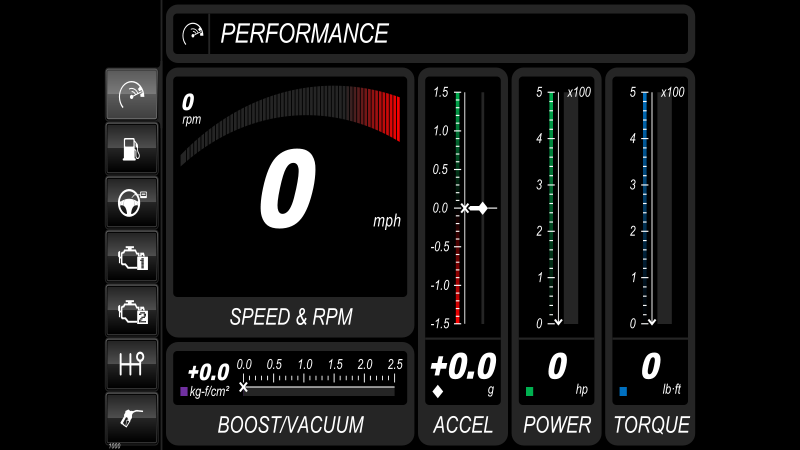

Just wondering, with all the paraphanalia about tablets and iPads, surely there must be software/hardware out there that utilises one of these devices
for a dashboard.
Had a quick search, but didn't find anything
I know that there are OBDII readers than can display this data, so there must be something more customiseable?
Ta.

this looks good, and sort of the idea
http://www.ecutek.com/products/deltadash/incardash/
and i think this link is a forum talking all about it and how to do it
http://www.mp3car.com/vbulletin/dashcommand/111407-digital-gauge-software-4.html

Found this:
http://www.palmerperformance.com/products/dashcommand/index.php
Downloaded it and it looks VERY cool indeed.
So obviously, going to struggle a bit with a BEC...
So that lead me here:
http://www.probike.co.uk/it080002.htm
So it seems that you can connect up the required sensors and emulate an OBD requirement. You can then attach your PC, which would be one of these:
http://cgi.ebay.co.uk/ASUS-Eee-PC-701SD-7-0-9-GHz-Laptop-PC-/300473336950?pt=UK_Computing_Laptops_EH&hash=item45f59b4476
Obviously you'd separate the keyboard from screen.
But now you have a problem with the screen because it's not touch sensitive?
So you get one of these:
[url]http://cgi.ebay.co.uk/7-inch-Touch-Screen-Panel-kit-Asus-EEE-PC-EEEPC-/300328211973?pt=UK_Computing_LaptopAccessories_RL&hash=item45ecf4d605[
/url]
The brilliant thing about that is it will allow you to mount the screen behind a thin perspex sheet for full waterproofing. You then bung the
touchscreen layer ontop and Robert is your mothers brother
Price wise, all in for less than £500, which I don't think is bad at all.

A big problem is whether or not the screen is readable in direct sunlight.

What about using something like this as the interface?
http://www.redstore.com/OEMNOT419

Kinda cool - you could make a lexus LFA-alike tacho.
I don't think you really want to be using a pc to drive it though. Even a stripped down one might take nearly a minute to boot up before you
can drive off, uuugh.
Be better off using something totally solid state with a stripped out linux kernel in it, or waiting until old iPhones start going for a song...

What's the refresh rate of an OBD link when you are monitoring multiple parameters? A second or so would be fine for temperature etc. but
utterly useless for RPM. Also having to wait for your dashboard to boot itself every time you start your car doesn't seem like much fun.
