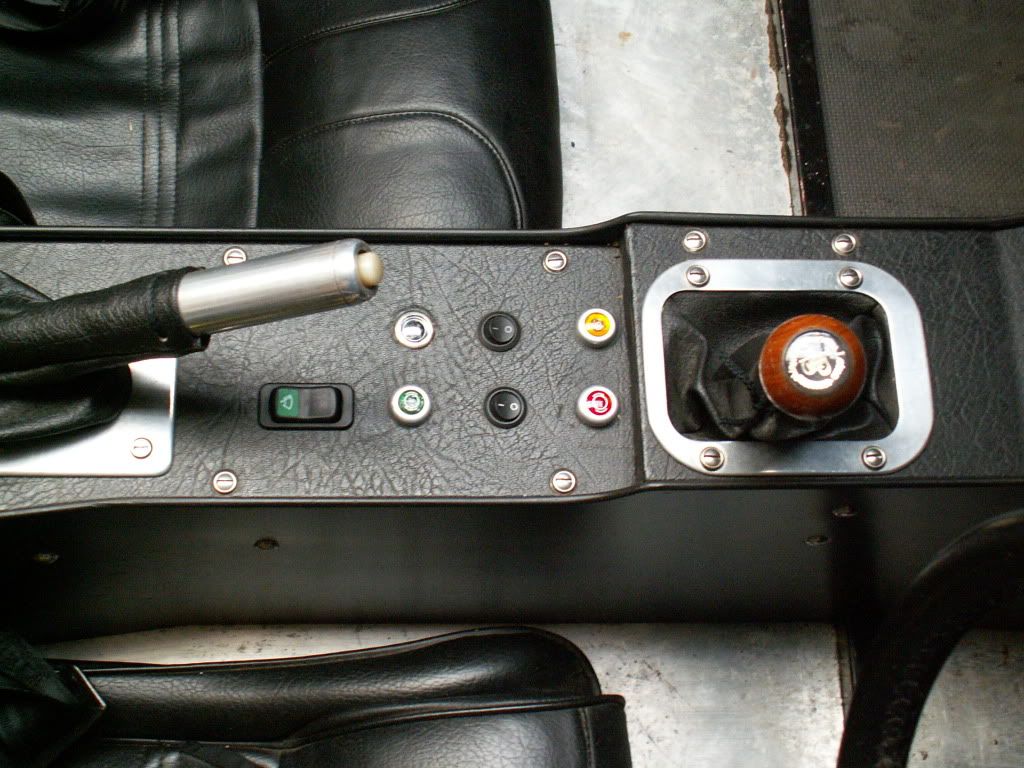

Someone was asking about switch positions recently. This is the way I have fitted mine:-
The top left is a push button for the windscreen washer. They are all nice and close at hand and keeps the dashboard uncluttered.

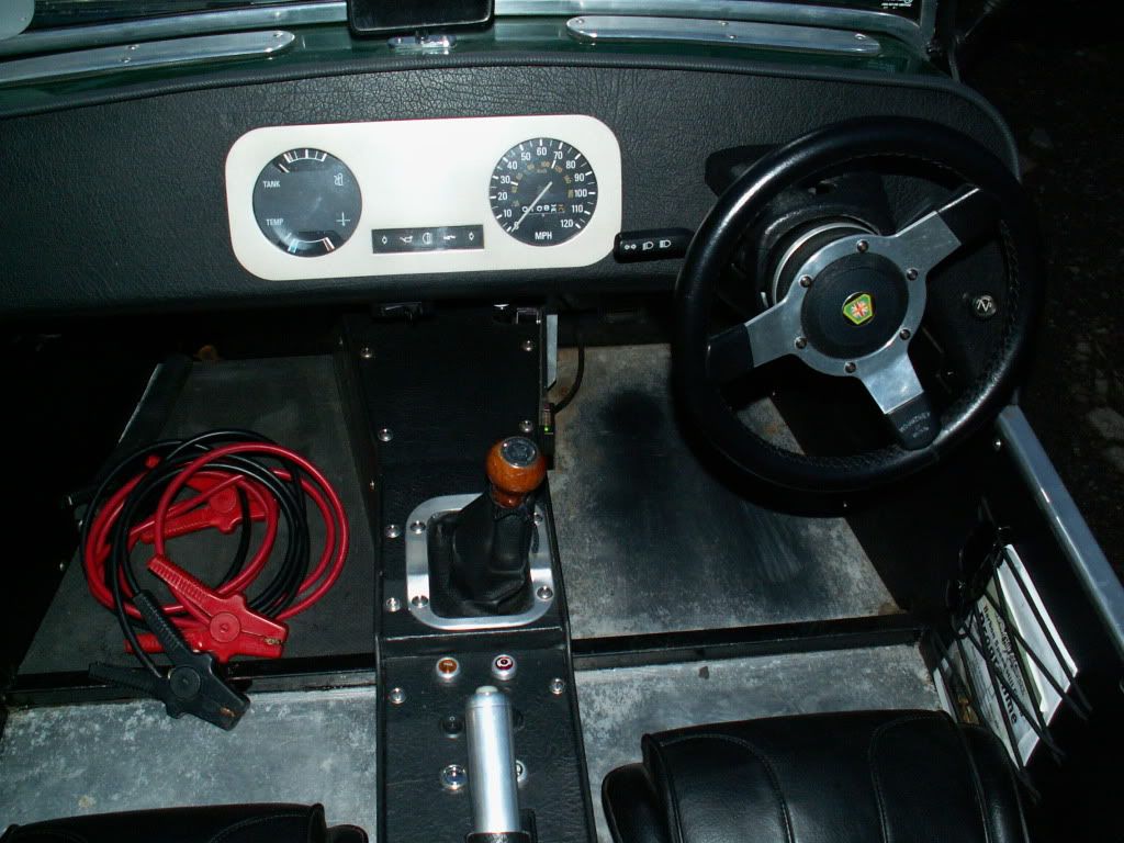

Wow! Fantastic looking interior.
Any more pics of the dash area etc.?

posted on 10/11/10 at 05:19 PM Reply With Quote
Mk 2 Escort instrument pod with the front cut flat, a piece of 3mm acrylic sheet stuck to the front and then the whole unit glued to the shaped piece of alloy. Kept in place on the dash by 4 pieces of thin steel sheet bent into a Z shape and secured around the back edge of the instrument pod on some existing screws. The alloy plates on the scuttle top cover slots that I cut for the demist vents but I got it SVA'd without a screen and havent fitted demist yet.
