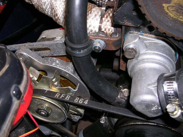

| posted on 10/7/04 at 04:25 PM |
Mark
Here's some pics of mine in situ,might just be able to see the main bracket at the botom pivot.
top bracket is just as crude but it works fine,also gave me something to bolt the hose from astra bottle too as it tended to move a bit when
hot.

crbrlfrost
| posted on 10/7/04 at 05:08 PM |
One of the primary reasons for the switch to serpentine belts is their ability to run as many accessories as you wish, via use of tensioners on the
back side. I'm not a specific belt expert, so take this as only something to look into, but V-belts have been known to turn themselves inside
out on high performance engines due to the types of strain they incur, and I'm thinking that a backside mounted tensioner might contribute to
this problem. Probably why they used to use multiple belts rather than snake them through a series of pulleys and tensioners. Just a couple of
thoughts in case they may be worth something. Cheers!
