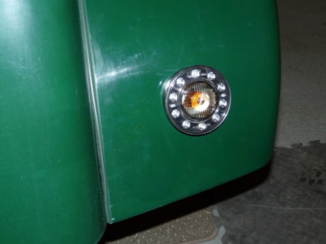

The outer ring is a LED stop and tail light from SVC
[img] First Light Fitted
First Light Fitted
[/img]
[Edited on 25/4/11 by big-vee-twin]
