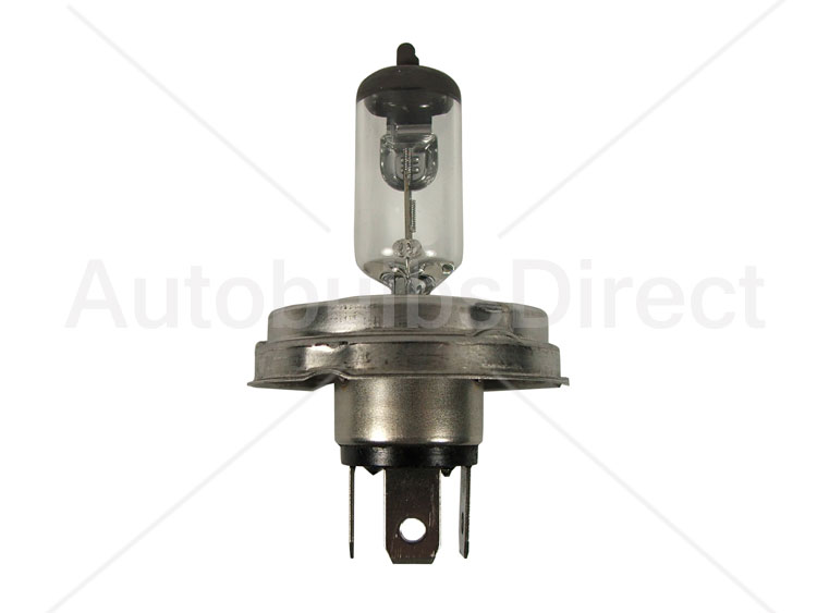

Hopefully i'm having a stupid moment because i cant work out how to fit the bulbs into my headlights!
They are Saturnus lights which i bought quite a few years ago from Newark show. Never really looked at the bulb holder part until now.
The hole in the back of the lamp is too large for an H4 bulb and doesn't have any slots for the location tangs.
Hopefully someone can look at my photos and shed some light onto things for me!

look like they''re for the old non_halogen bulbs. canz't remember the number. hard to be sure from the pctures as i'm viewing

Hb12 me thinks.
http://www.autobulbsdirect.co.uk/images/D/hb12-750.jpg
http://www.autobulbsdirect.co.uk/HB12-Halogen-410-fitting-P45t-Headlamp-60-55W.html

The bulb holder is a P45T pattern, a halogen conversion bulb isn't allowed for IVA it has to be the original pathetic
contintental style tungsten bulb.
Auto Electrical Supplies have them part number 131603
http://www.autoelectricsupplies.co.uk/product/510/category/93
http://www.autoelectricsupplies.co.uk/image_uploads/131601_1_med.jpg
They also have the tungsten conversion bulb for after SVA part number 131604 and also err... non-highway use uprated bulbs.

I got two P45t bulbs and they fit!
Thanks for your help!
