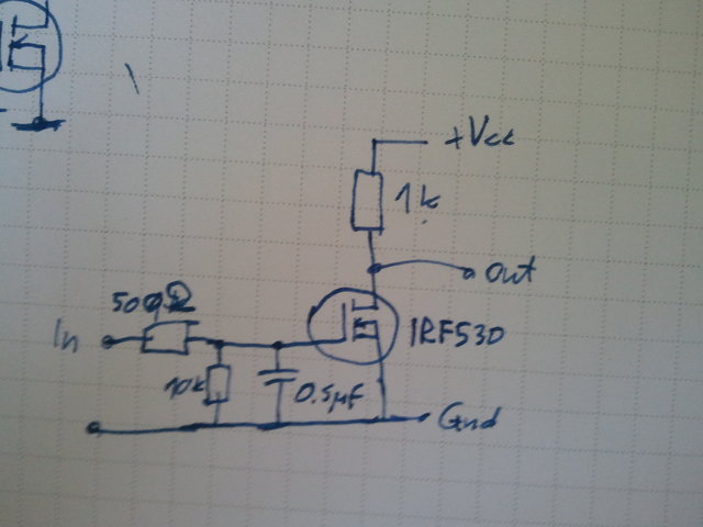

my mate made converter for sierra dash, because did not work with modern zetec ecu.
chematic - capacitor is not needed
