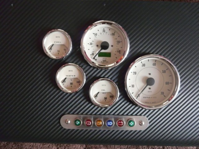

big-vee-twin
| posted on 24/11/14 at 11:02 PM |
Smiths
[img]
  clocks
[/img]
[Edited on 24/11/14 by big-vee-twin]
