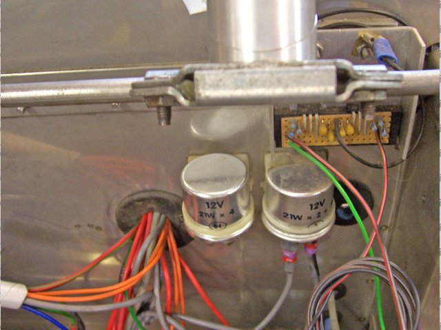

Fuel gauges work in conjunction with a voltage reducer.
(often attached to the speedo)
Modern equivalent (circuit board bit)
  alternative needed, I think
