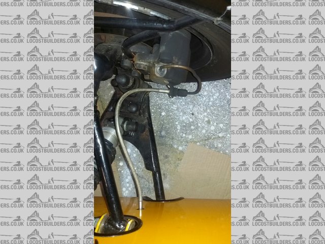

Welded bracket on M16.
Was going to use banjo but vaguely remember IVA / moving part / possible coming undone - somewhere someone was pulled up on and failed - so mine was
belt n bracers for IVA.
Welded bracket inner.
