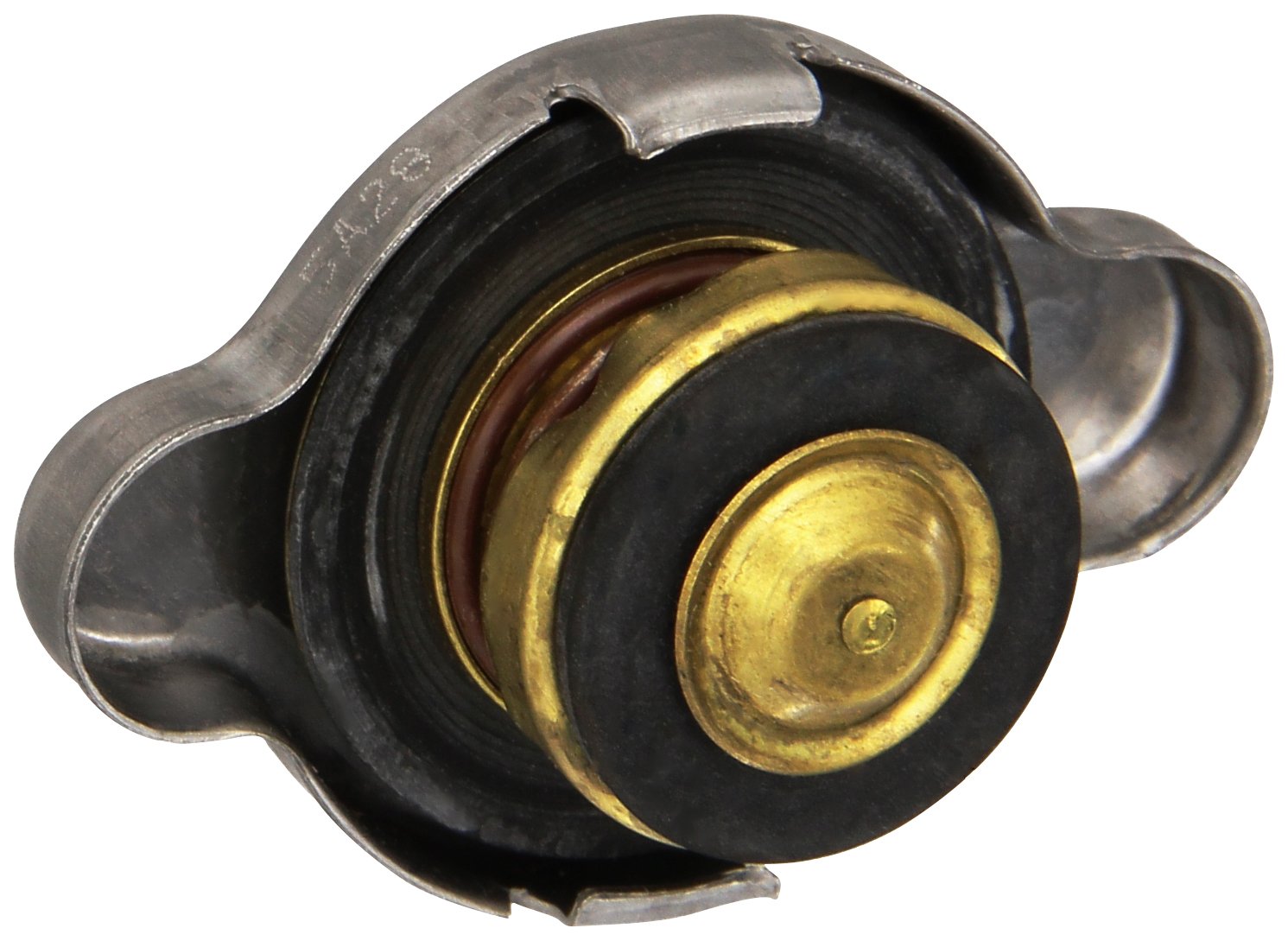

your fiesta thermostat housing needs to have a pressure cap with 2 seals (and 2 valves) otherwise this open system does not work!!
during expansion valve 1 will open and let water expand into your "open" bottle..which could be even positioned on a lower level.
when the water cools down the created vacuum in the system will open valve 2 and sucks back the epxanded water from the bottle
important: the hose to te bottle needs to be connected on the bottom of the bottle or needs to be stuck inside the bottle until it reaches the bottom.
your radiator needs a blanlking cap.
above system works bomb-prove...so you do not really need to change things...just a cap maybe.

i´m talking about such a thermostat housing. onto this you will fit the cap with the 2 seals...simlar such one:
