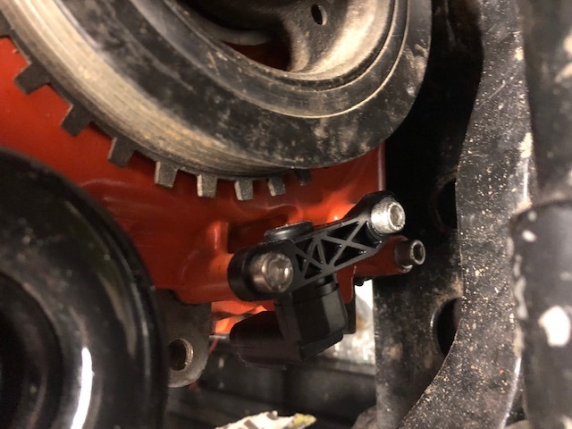

Also it looks like the sensor is too far away. What are people’s thoughts?

itsawindupuk
| posted on 29/5/19 at 10:05 PM |
[img]http://
[/img]
snapper
| posted on 30/5/19 at 05:49 AM |
Way to far
Usually about 1mm clearance

Well this evening I look a closer look and it cannot be mounted closer. I have my old st150 engine still so looked at that. On the front engine cover
around the crank pulley is a recess for the pulley. The recess on my st150 matches the pulley exactly. On my current engine the recess is noticeably
bigger.
I recall having 2 pulleys as I had another wrecker engine and chose the pulley the same size as the st150.
So basically, the front cover is designed for a bigger diameter pulley and I need to change the cover to an st150 one. Where the hell am I guns get
one lol.

No I tried that but the engine cover has a slant in it and the sensor hits it bringing it too far forward of the trigger wheel.

larger diameter trigger wheel,.?
