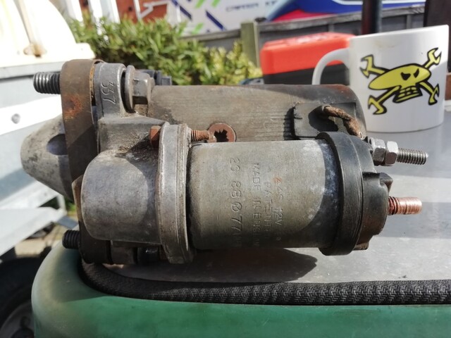

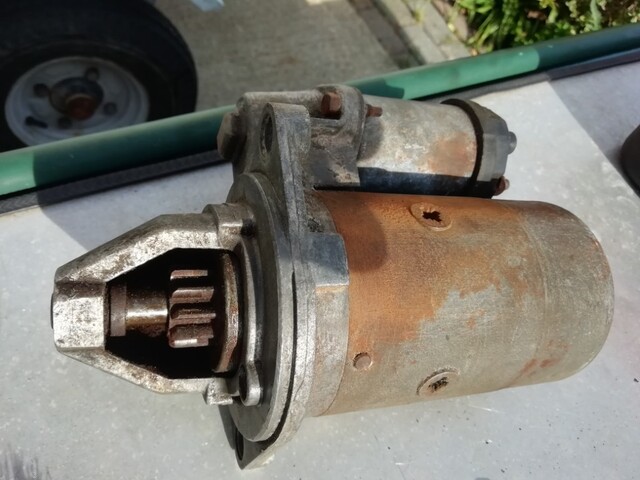

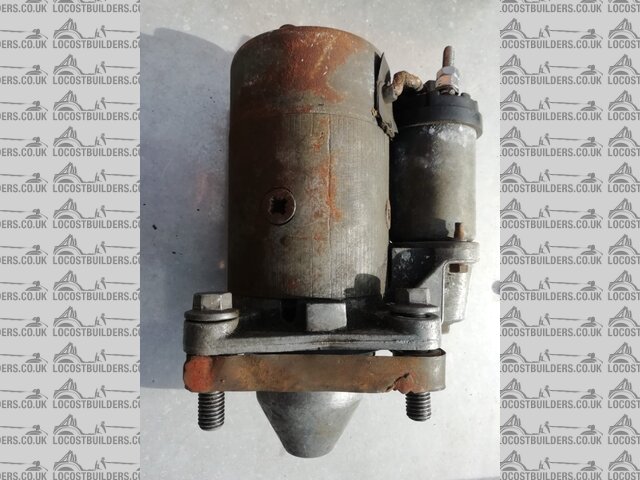

My old starter I had to make an adapter as the throw was wrong
(it moved the starter about 10mm further from the flywheel)
Not sure what the starter was off originally I was working at a scrapyard at the time and just found one that looked like it may work, which it did
till I killed it with brute force
only marking I can find is "337" stamped into an ear and some markings on the solenoid can
(either way - would rather do away with the adapter thingy as it makes the job of fitting and removal that bit more complex)

crimondbanger
| posted on 17/4/22 at 09:45 PM |
looks like you have a pinto starter. the zetec flywheel is 16mm closer to the block than a pinto one hence why you needed the spacer.
Starters that will work without a spacer :- sierra 1.8 cvh/ sierra 2.0l dohc/ granada 2.0 dohc /scorpio 2.3l dohc / lrs707
I've used the ford scopio 2.3 1.4kw bosh starter as it was the smallest high torque one i could get ,
They all have different body widths and can have the solenoid on top or the bottom , so best to go to your local starter refurb place and take yours
with you. They could also repair the one you have , changing the solenoid is pretty simple.

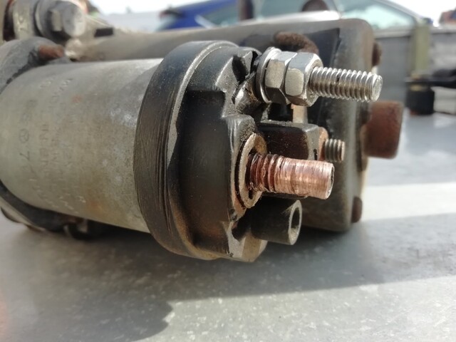

Is the solenoid on a ring terminal or a push on?
Might as well get that side sorted if it needs doing - currently on a push on fitting (M5 or m6 threaded?)
Not sure I have any ring terminals that are that beefy
Its a ring terminal same as on the Sierra my original starter came off.

robocog
| posted on 22/4/22 at 12:29 PM |
cheers for that
The push on terminal may go onto the stud, will wait to see when it lands
