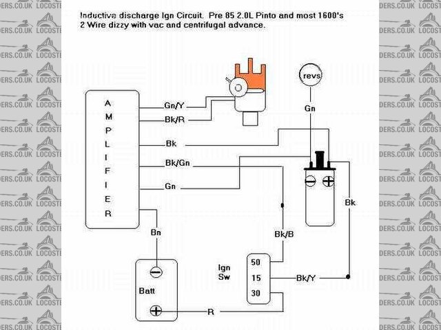

ive got a 1.6 pinto (83 reg) and ive just bought an ignition module for it.
in the picture ive got my connection from the distributor and in the other picture ive got the ignition module.
has anyone got an idea how to wire this up,
any help much appreciated.
bob

found this in the depths of my pc
the moa 2
| posted on 7/5/05 at 09:04 PM |
cheers bob that should do the job.
bob
| posted on 8/5/05 at 08:15 AM |
No probs
There was one wire i didnt use on the plug,i think it was white and in the middle.
