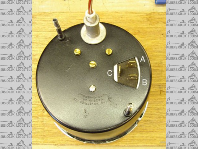

Hi All,
The electrical dimwit is stuck again.
I have a smiths rev counter that has no markings to indicate what goes where.
All three are insulated from the case so I will need an earth on that to make the bulb light,
but A, B & C have me stumped.
A "pos", a "neg", & from neg side of the coil ?
Cheers for any help.
Paul G

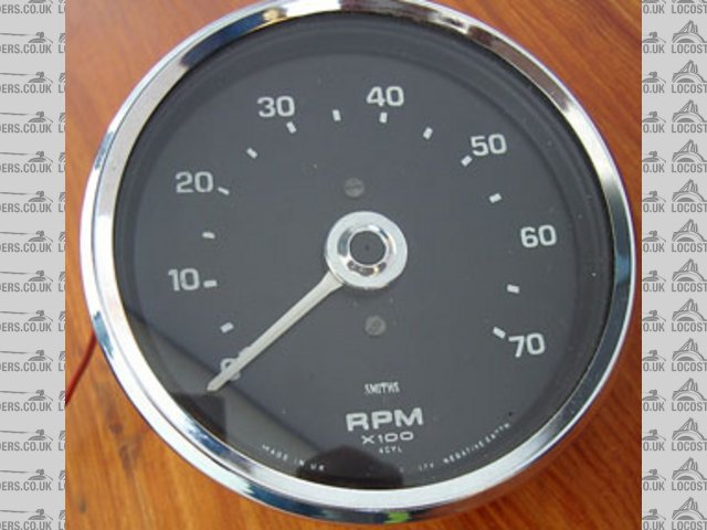

907
| posted on 18/8/05 at 10:45 PM |
Pic of Face
No numbers, just "neg earth"
Paul G

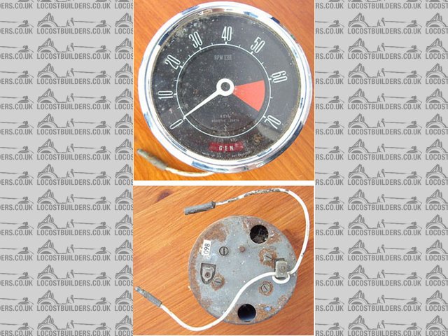

907
| posted on 18/8/05 at 10:49 PM |
Or I'v got this one
Trouble is, to do 7.5K I'll have to move the spider.
Any ideas ?
Paul G
johnjulie
| posted on 19/8/05 at 09:06 PM |
The bottom one with the looped wire at the back is an IMPULSE TACHO, one side of the loop goes to the ignition switch, the other side goes to the
coil. You also need a live feed and earth to it. Not sure about the top one, looks in better condition. What Speedo are you using? Surely you want
matching gauges?
Cheers John

907
| posted on 19/8/05 at 11:00 PM |
Hi John,
The pic in post 1 is the back of post 5.
As you can see it's in very good nick so I would prefer to use it if I can.
It has no numbers on it at all, just "Smiths" " made in UK"
The one in post 6 is from a MK II Tina and has the number "RV1 2413/00" by the N in GEN. (ignition light)
Most of the marks, including the dead spider are on the inside of the glass, so I think it would clean up OK.
So to wire up I take the wire off the + side of the coil and join it to the white wire (male bullet ?)
and the other white (female bullet ?) to the + on the coil, effectively adding it into the ignition switch to coil line.
The spade on the left of the pic then has another live to it ? Then a - (earth) to the case.
All my gauges are Smiths white on black so they sort of match. ( see interior thread, "Finished my Dash" )
Many thanks for your help. I realy do get stuck on this sort of thing.
Paul G
[Edited on 19/8/05 by 907]

907
| posted on 22/8/05 at 09:02 PM |
YIPEEEEEEEE
Problem solved at last.
Took the tacho to a mate who does fuel injection work for local garages.
He put an amp gauge on all the terminals and detected a reading of
250 mAmps between B and C. No reading between AC or AB.
So A is signal from neg side of coil.
B is positive (feed)
C is negative (earth)
IT WORKS
Thanks for all your replies
Paul G

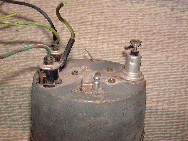

| posted on 29/8/05 at 07:15 PM |
How about helping me with this SMITHS rev counter. It is from a Jaguar.
The numbers on the face reads
RVC 2610/01AF
3 terminals on the back.
Spade terminal to the body (I take this as earth) And then a round terminal and another spade terminal insolated from the body.

| posted on 30/8/05 at 09:23 PM |
The Spade terminal goes to a live feed from the a fuse that is only live with the ignition on.
The Bullet connector is wired to the -ve side of the coil.
The Spade on the body of the Tacho goes to earth.
Standard Smiths Tacho wiring for -ve earth vehicles.
Cheers John
