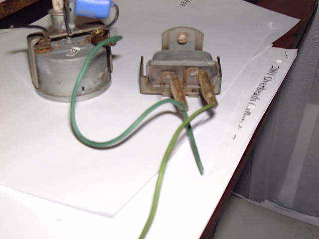

One of my pictures got lost in the net.
I will try again.
What is the little blue thing and the little box with the green wires attached?
The backlight is a sepperate holder.

theconrodkid
| posted on 4/9/05 at 01:11 PM |
that box looks like a voltage stabaliser,used for fuel/temp gauges so not part of voltmeter

johnjulie
| posted on 5/9/05 at 08:36 AM |
The box is a voltage stabiliser, as already stated, and not required for a voltmeter. The blue thing looks like a capacitor. Are we looking at the
back of the voltmeter, or a different gauge?
The capacitor could be fitted to act as a radio suppressor, how is it wired?

kango
| posted on 5/9/05 at 10:11 AM |
the blue thing is earthed under the knurled nut in the middle of the guage.
The other side is joined with the plain green wire on one side of the guage(-)
The plain black wire to the other side of the guage and the G/B to another terminal on the voltage regulator. I bought the guage with these wires
on.
Say the person stipping the guages incorrecly placed the fuel guage retainer on the Volt meter, how does this get wired into the fuel guage?
johnjulie
| posted on 6/9/05 at 06:18 PM |
The voltage stabiliser has three connections, I, goes to one side of the gauge, B, goes to a live terminal that is live when ignition on. The E
terminal is connected to earth. I haven't seen a capacitor used before.

omega 24 v6
| posted on 6/9/05 at 07:35 PM |
it looks like the capacitor is connected to the live of the bulb does it not (strange).
Perhaps a photo with the stabilizer removed might help us decide whats what.
I would agree that all thats required is a live and earth to the volt meter ( Only cause thats all i've ever seen mind you)
Syd Bridge
| posted on 7/9/05 at 08:45 AM |
What you have is a gauge, and a voltage stabiliser, as has been said above.
The voltmeter wires up to switched power(unless you want it reading at all times), earth and dashlights/sidelights.
The stabiliser I have recent experience with. It puts out a lot of RF interference, and can cause serious problems with electronics as well. I'd
say that the capacitor/condensor has been added to damp the stabiliser. Best off to bin the thing, and use the electronic alternative.
Oh, and the output of the stabiliser should not be connected to the voltmeter.Obviously, but not to some.
kango
| posted on 7/9/05 at 05:50 PM |
Hope this helps. It is definately a capacitor 1Micro Farad and 150 V DC.
The voltage stadiliser has 2 terminals "I" and "B".
johnjulie
| posted on 7/9/05 at 06:17 PM |
The I & B terminals are as I already stated, the earth is connected to the body of the stabiliser, usually when it is fastened to a gauge that has
the body connected to earth already. Forget about the capicitor, a previous owner has added this because of some form of radio interference, or
something similar.
Cheers John

kango
| posted on 7/9/05 at 06:24 PM |
And this stabilizer should be used on the Fuel guage.
Is this correct?
MikeRJ
| posted on 7/9/05 at 06:32 PM |
Is this correct?
Yes, and the water temperature gauge.
It basically provides a stable, regulated voltage for the guages, so that the fuel and temperature readings do not move around as the RPM changes
(which causes the battery voltage to change as the alternator provides more or less charge current).
As Syd pointed out, these old mechanical regulators can produce interference on radios, the capacitor is there to help prevent that.
By the way, you should connect the positive input of your volt meter to a igntion switched circuit rather than directly to the battery.
